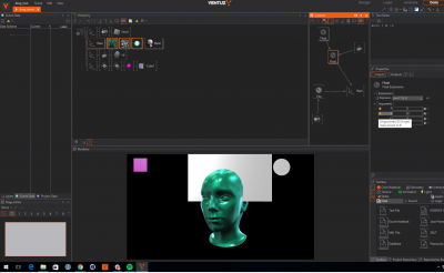

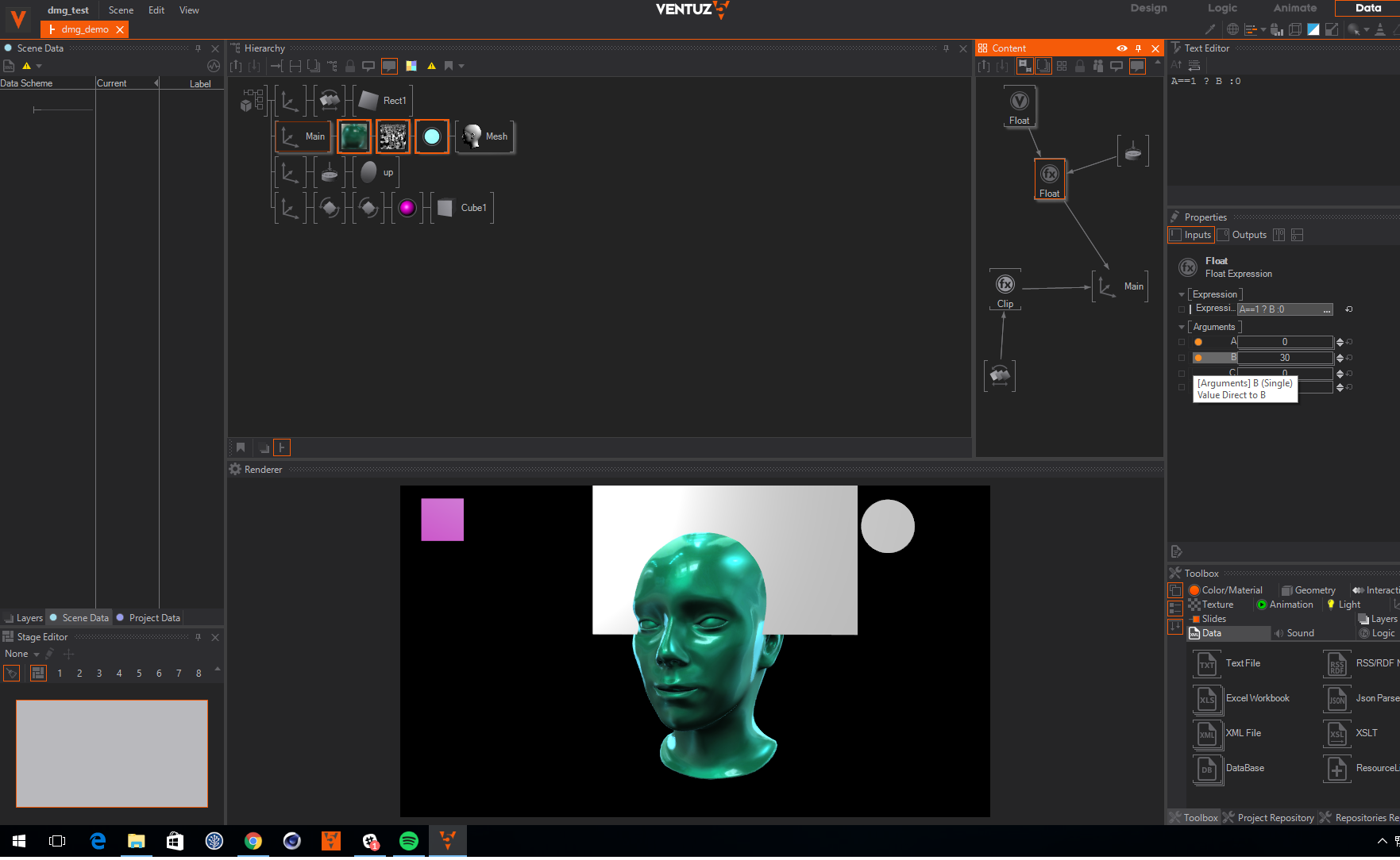

I am learning ventuz, and cannot figure out how to accomplish this simple task.
lets say i want to rotate a cube everytime I click on a circle. right now i am using a "touch button" assign to the circle to increment in 30 degrees the angle.(attached image, node on the top to the Main axis)
the problem is that whenever i release the mouse button, the angle goes back to the original amount, and i want to actually add 30 degrees everytime I press click on a object.
thank you!
Simple rotate button
Re: Simple rotate button
You're using the prssed flag I guess. That will snap back to 0 once you release the mouse. Use the "single tap".
If you want to step 30! at a time, use a counter, bind the forward event to the single tap, put the result through your expression, use a damper to get a nice animation. See vza.
If you want a full 360° (or something similar that ends with the same state that it starts with) use a mover in "one shot" mode. See vza.
Buuut... I wouldn't recommend using "single tap". On tough screens this makes problems whenever the touch is not exact enough. A slight movement of the finger will be considered a swipe, not a single tap. So I usually use the "touch pressed" flag and throw that into an event and use that. See vza
Just have a look at the samples in the vza, they are pretty straight forward.
