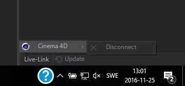

I have the same problem!
Win10, Cinema 4D R18, the plugin inställs and the tags are there to add but in Ventuz the Connection cannot be made, all I see is this [see attached image] (even after hitting force refresh in the C4D Ventuz Setup Link)
Ventuz version is V5.2.1.182 R15672
C4D version is 18.028 Build RB177006
I've used the live-link succesfully with earlier versions of Ventuz and R16, even under Win10, so I guess it's not only a Win 7 / Win 10 problem here....
Best regards,
Sam
Best regards,
Sam
- livelink_issue.png (26.96 KiB) Viewed 18627 times
