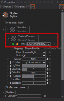

Hey Christian,
In V5.1 and higher the RenderCubeMap Node has a texture output property. You can expose that property and bind it to the Input of e.g. a Skybox Node in the other layer. Change one of the Texture Property Groups to an Empty Texture Property to do that:
Hope the RenderCubeMap Node is what you meant.

Re: CubeMap layer
You can not bind it to a File Property!!
You have to bind it to a Texture Property. Create a Material and then create a Material Stage with a TextureProperty-Empty.

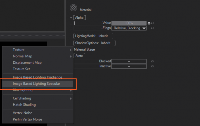

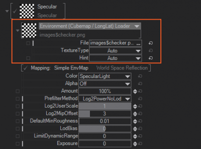

Re: CubeMap layer
FYI:
Since you want to use the CUBEMAP you must use a "Material Stage -> IBL Specular".
The IBL Specular is the only stage that has a "Cubemap / LongLat loader"
So, basically follow the guides from Daniel and Stephen but use the "image based lighting - specular" stage.
You can still map the TARGET to anything else than "Specular/ Specular Light" !

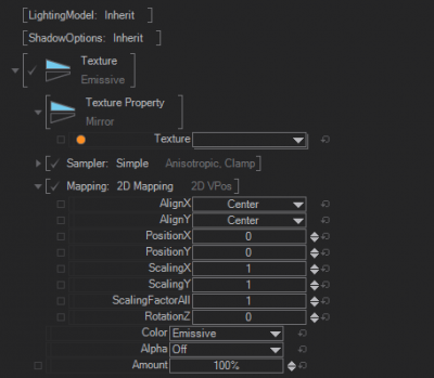

Next Thing:
If you use a MIRROR:
The mirror has a Texture Output as well. To make use of the MirrorTexture you would need a Material, Load it into the Empty Texture Property BUT:
For Mapping you would need to select "2D Mapping -> ScreenAligned".
Hope this lights up the topic a bit
