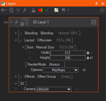

Hey,
did you find the Size property in the Layout Property Group once you have set it to Offscreen? You might need to expand the Layut Group by right clicking. You can change it to any Item in Manual Size to be able to adjust the Width and Height manually.

I put the osc node in Content leve.and export the osc output. The layer cannot connect himself;
as you say, the osc node can put on the layer level.And the layer properties can connect the properties from layer level node.
