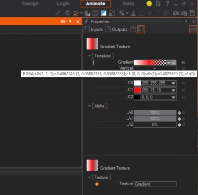

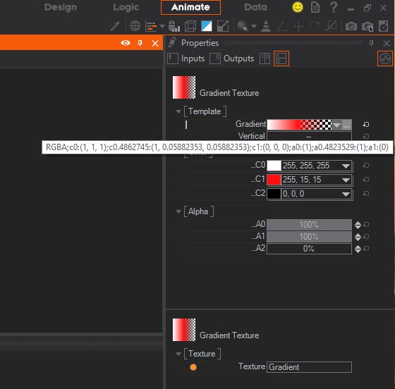

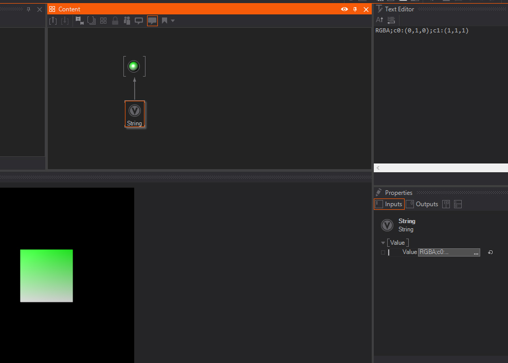

With the gradients, do you have a simple example for this?
I can only hover with the mouse over the edit gradient button to get the resulting string. Not a easy way to get this string as an editable parameter, or miss i something?
But have no clue to get such a string as an input for the gradient.

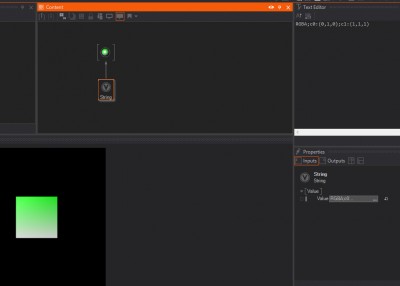

Gradient input string
thank's

Ahoi Joschy,
why dont you simply connect a string to the gradient? :D
*bind the gradient to the string.. simply drag and drop and get the value from the string...*
the formatting for the string is like:
RGBA;c0(0,0,0);c2...
c0 = is the first stop, followed by rgb values....
best regArts
:ugeek:

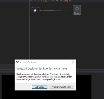

Post by joschy » 03 Jun 2016, 10:54
sounds simple, but...
error
may be it's my fault, because the string is empty ;)
Dennis
Posts: 384
Joined: 08 Jun 2015, 11:29
Re: material handling
Post by Dennis » 03 Jun 2016, 11:39
Nope i connected an empty string aswell...
changed the string.. (the old gradient was still valid and used.. until i changed the string to a valid string (i missed RGBA; in my case))
as soon as the string was valid, it worked and used the string...
latest version? (v5.0.2.126?)
regArts

Post by joschy » 03 Jun 2016, 12:11
yep, latest version. I've tried it again and now it works ;)
also your archive file.
Cool feature 8-) good to know
thank's

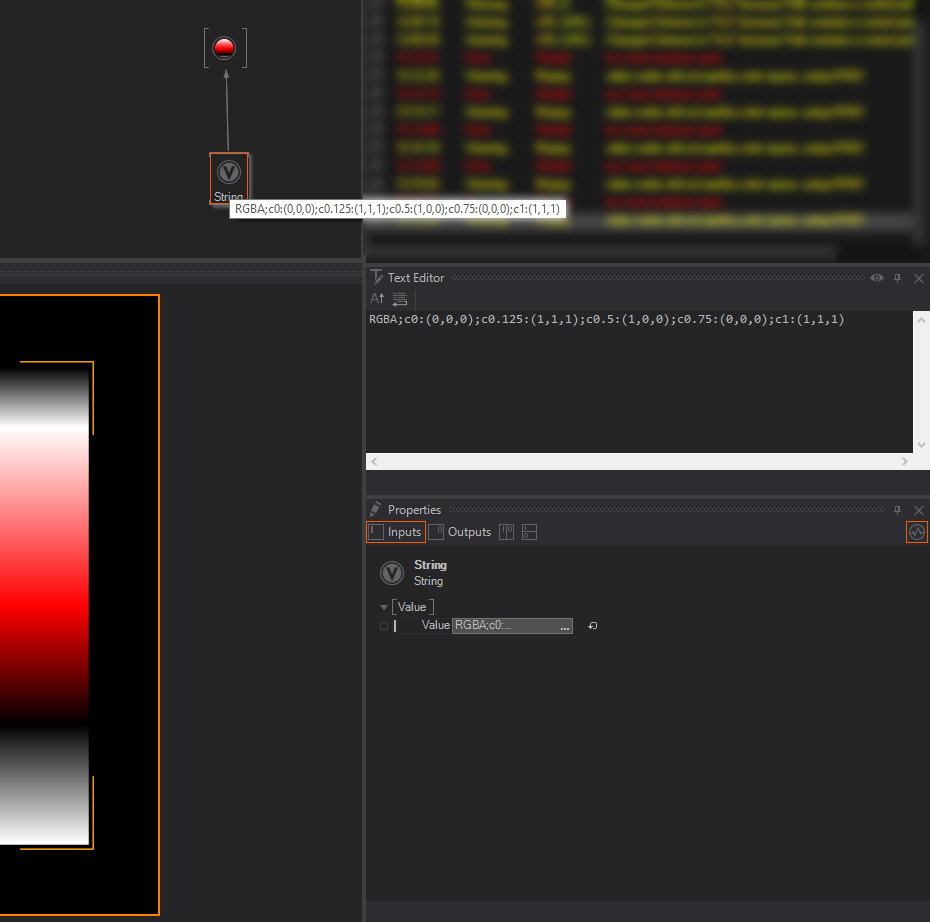

Btw ...
C0 = the "0" is the position for the STOP.
c0.125 = moves the Stop-Point
e.g.:
RGBA;c0:(0,0,0);c0.125:(1,1,1);c0.5:(1,0,0);c0.75:(0,0,0);c1:(1,1,1)
the "C's" define the stops in a range from 0-1
result:
PPS:
to create a HARDSTOP... simply set:
RGBA;c0:(0,0,0);c0.125:(1,1,1);c0.1251:(1,0,1);c1:(1,1,1)
Best RegArts
:ugeek:
