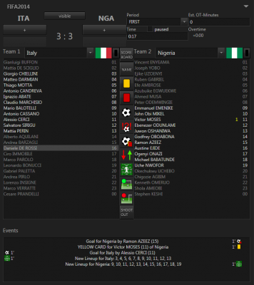

the Director has a Plugin API to write custom plugins.
There is an introduction in the Director section of the usermanual. The full description is in the Ventuz API and SDK Reference.
A plugin can be anything from just a small function to a full custom ui.
Robert and his team from Avantgarde are quite busy:
http://forum.ventuz.com/viewtopic.php?f=49&t=4174#p8653
