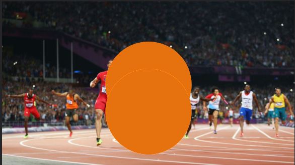

Hi there,
I want to build a lower third with 3D shapes separated on 3D layers. But when the shapes overlaps appears a ugly antialiasing border. That's not fine.
I've tried layer orders etc. to get rid of the border, no success. Is there a solution?
My current workaround is, build all in one 3D layer.
AABorder sample
AABorder.vza
V5 scene, no PLE
(233.66 KiB) Downloaded 896 times
tia joschy

hi jochen,
i think you have to change the aa settings of the layer
greetz
christian

yepp...
change aa setings of the layer to fxaa... or if you leave it on "as avconfig" change settings in av config ;)
greetz
christian

Jep, FXAA make it ...
Thank's Chris

Dierk mentioned that in his speech when he talked about gamma correction ;)
In the graphics driver under 3D Settings you can set Antialiasing Gamma Correction to Off and the border is gone. (This is for Nvidia, dont know the exact name for ATI)
Götz

Had a similar problem on a show this week where I was using Ventuz to composite layers to output as a video.
Couldn't find any settings in the AMD/Ati settings. The only way I got this to work was to go into the layer blending settings and select the setting at the bottom - about not pre multiplied alphas or something similar. Sorry haven't got a Ventuz in front of me so doing it from memory. This was the only way I could get a png overlaid in one layer, to give me a clean edge over another.
Peter

chriss0212 wrote:yepp...
greetz
christian
@joysprod
this should fix your issue as well.. since your using an AMD card
