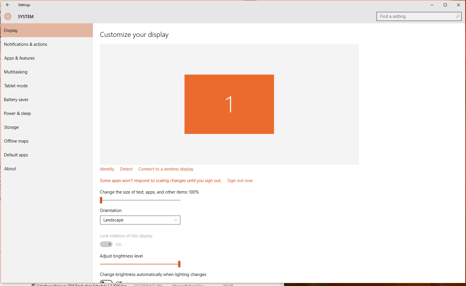

Yep I have had the same issue. But it actually happens to be more of a windows issues than specific to ventuz in my opinion.
Go do you desktop and open Display Settings.
Set Scaling to 100%.
Log out and back in (if requested as seen in attached image)
Confirm Scaling still set to 100%
Open Vetnuz and you should have it looking right.
After it is open you should be able to then adjust to what ever you would like and it will adjust correctly. I have a few other programs that I have to do this with. Very annoying, but this work around will fixes it for me.

Re: Incorrect display 4k interface
Thanks Sherman!
Yes this is correct, its a scaling issue from WINDOWS and we can hardly do anything to prevent this.
we are sorry, but the workaround/fix is really to disable scaling or set it to 100%
Hey guys, one thing I found in Windows 10 is that you have to set it to 100% first, but then you can actually set it to a different setting afterwards and it seems to work. So, set it to 100%, enjoy the itty bitty icons for a second, (sometimes you have to re-log), and then set it to 150% or 200%. For me, it seems to work. Not the most elegant, but as Dennis said... this is a Windows Thing(TM) and there is not a lot we can do about it right now.
