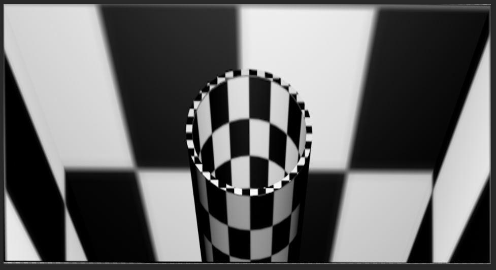

I attached another photo of the end result I am trying to achieve. This is a "top down" perspective of the pre-camera mapped texture which would be set to the desired viewpoint that would update based on broadcast camera location.
Thoughts?
This was helpful and saw this in an earlier Archive Forum post... but did not solve the challenge.
It appears that if I have a camera in my master scene (which is needed to do the camera remapping) It will not use the camera data in the new scene with the Scene Port.
Thoughts?
