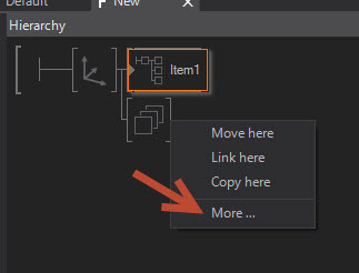

I might be misunderstanding what you are trying to do but will the container information node not help you out? From this you can create containerised instances and access their index.
There is a helpful little menu that not many people know about where you can access by holding the right mouse button when you drag a node. On mouse up you will get the following menu:
Create Instances.jpg (13.93 KiB) Viewed 24193 times
If you select more you can choose how many instances.
Attached is a little example scene showing how we use containers :)
