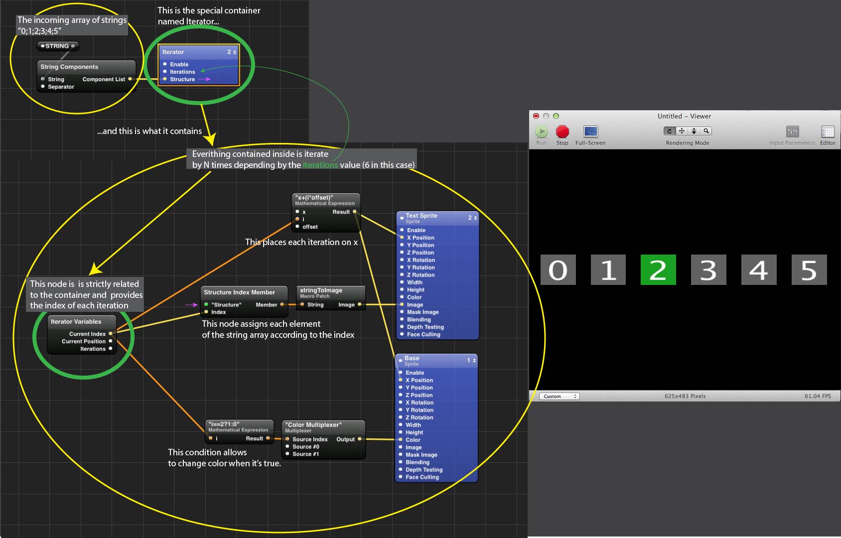

One of the features that I miss the most is the possibility to iterate objects being able to access their index. To explain better I attach a simple example of how this works in Quartz Composer (of course my intention is not to compare Ventuz with QC which is almost dead).
This feature would allow thousands of creative solutions.
Basically you are already close to this solution with the spread node. It would be really great.

Hey,
you can't "spawn" objects in Ventuz which is one of the major weaknesses. But you can use containers to achieve something similar. Skype me and I'll tell you how ;)

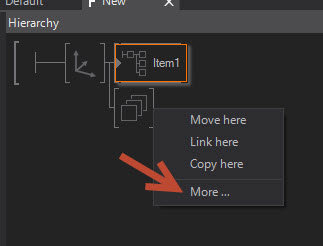

There is a helpful little menu that not many people know about where you can access by holding the right mouse button when you drag a node. On mouse up you will get the following menu:
Create Instances.jpg (13.93 KiB) Viewed 24186 times
If you select more you can choose how many instances.
Attached is a little example scene showing how we use containers :)
