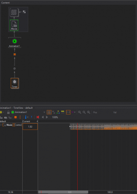

I did something similar using an AnimationNode as controller of the MovieClipNode. If you set a keyframe for the Control property at 0, your clip will be shown in the timeline. At that point you can control the timeline with a TimelineControlNode and with a bit of logic I think you can reach your target.
What I noticed, TimelineControlNode works at decimals of second.

Re: Video playback controls
...but actually you could do all the same just with the scrub function.
I used that technique with AudioNode where there is not scrub function.
