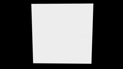

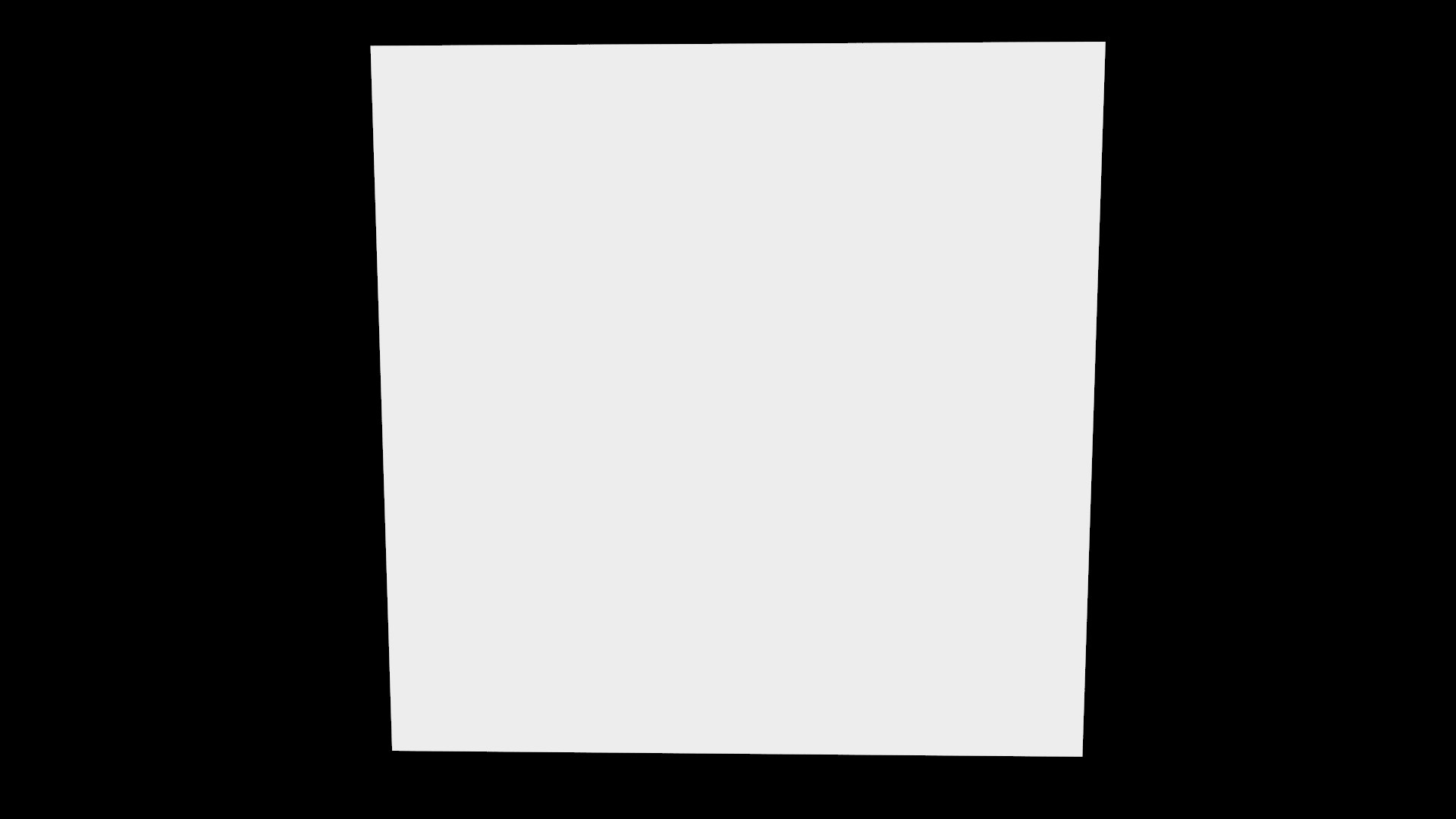

The light used in Ventuz has several components. I'll show it to you with a simple scene. There is a rectangle with a very high tesselation and a light source that is slightly tilted.

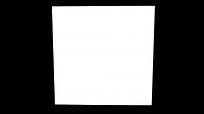

- Ambient: this is light that is added to the object no matter what. No dependencies. As you can see in ambient.jpg: all parts are lit the same

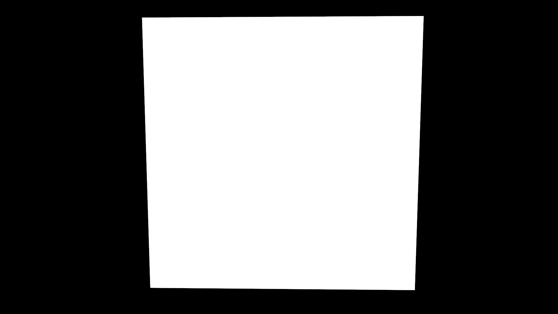

- Diffuse: this is light thrown on the object by the light source. The amount of light (the brightness) depends on the angle between the surface and the light source. For a directional light the light direction is the same for each position on the rectangle (because it's flat). Check out diffuse.jpg, it's also just a single color all over the surface.

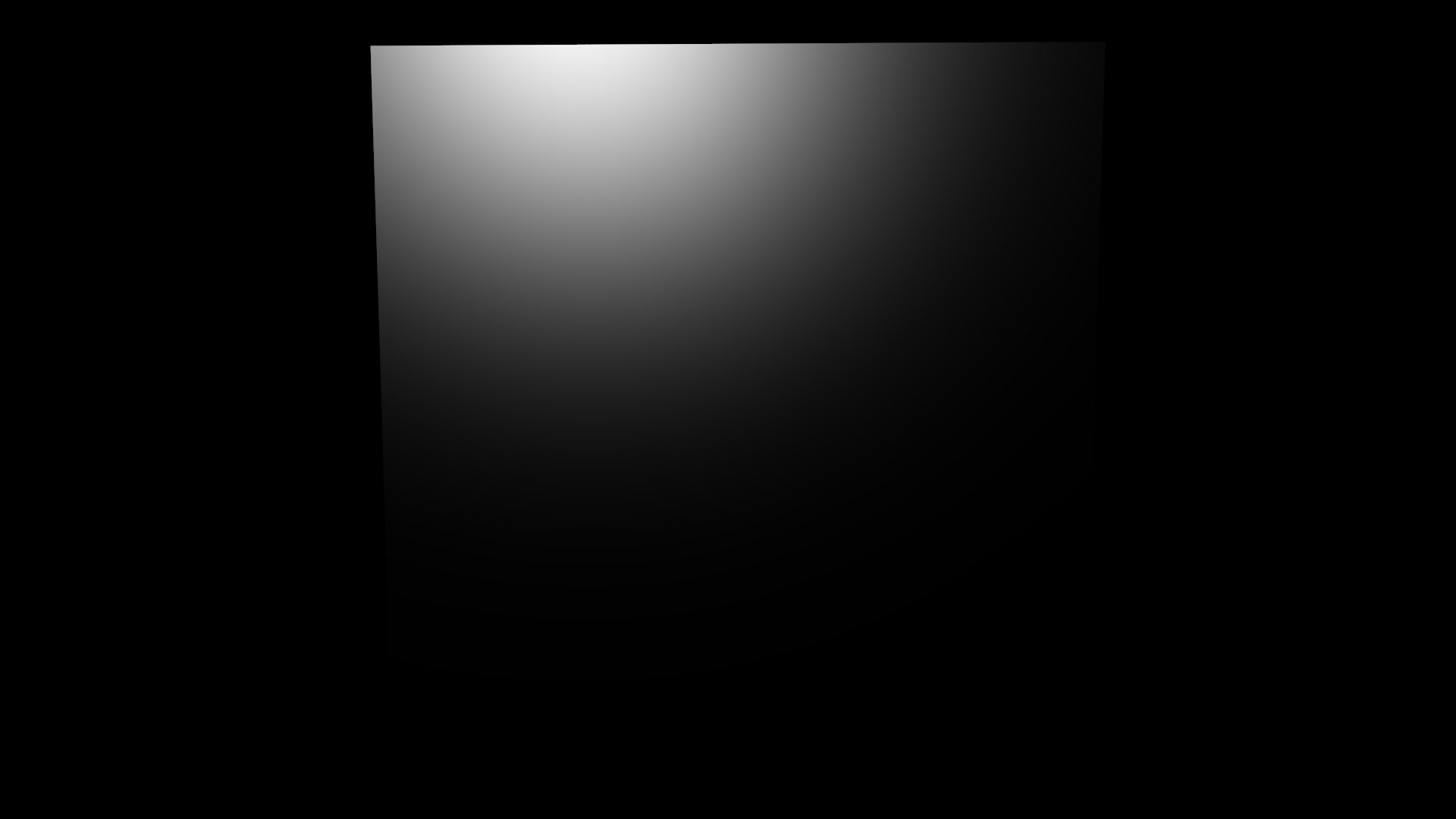

- Specular: this is the one that depends on the light direction and the direction towards the viewer - or the angle between those two directions. It simulates the reflection on different surfaces. Look at specular.jpg. The light direction is the same everywhere, but depending on the angle you're looking at it (imagine your eye being a infinitely small point at the camera position) the amount varies. It's like the sun's reflection on a window. The light direction is the same. But you can move around to either see the sun's reflection or not - the view direction is important.

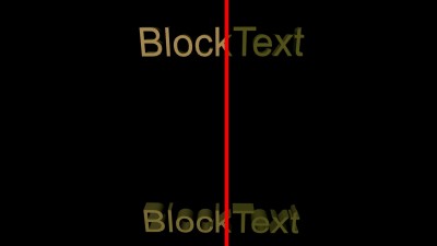

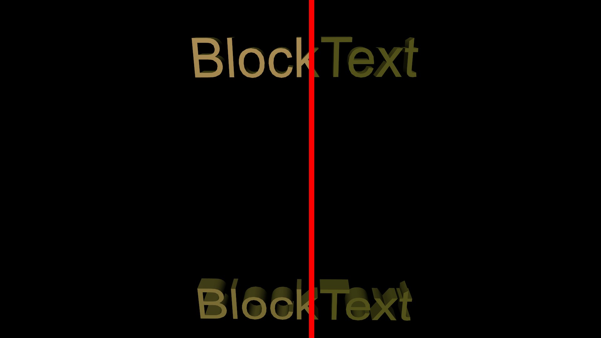

So if you're using the specular part, you will get different results with your texts. Try to disable that for a test. Use only diffuse. The last image (compare.jpg) shows that. Left side: diffuse + specular. Right side: only diffuse. You can see that on the left the colors are different and on the right they are not.

a directional light has no position. The light direction is the same for every vertex, so the position of the element does not make a change. BUT: the direction from the object to the camera matters!
