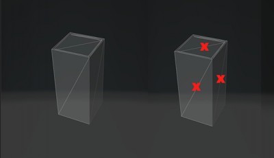

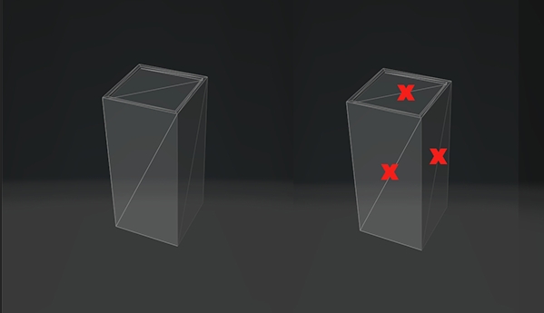

Post by Steve-C » 07 Jul 2015, 05:23
hi, i'm new guy. nice to meet you.
this is what i want to do. i did this by cinema 4d.
this is by cinema 4d
i was trying same look by ventuz but this only i can have. how can i disappear red x line?
is ventuz can do this?
this is i do by ventuz
thank you very much
Steve

Ventuz supports only triangles, so any polygon is triangulated. That's why you get those diagonals. A quad is divided into two triangles.

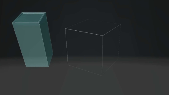

it´s like Rou wrote, you can only see triangles in Ventuz in the wireframe mode.
You should put a wireframe styled texture on the mesh to get the same result. Map just each quad with the attachment texture.
See also the vza file with the result.

Wireframe texture with alpha
Wireframe_Quad.vza
Wireframe Quad in Ventuz example
(13.15 KiB) Downloaded 380 times
