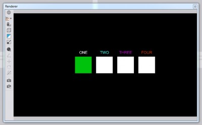

I have a strange problem happening with an interfaced container when the contents are updated via the "Paste Container Content".
Four containers (1-4) all identical, have a text field, a text colour and a diffuse material value exposed.
See different screen grabs of before and after applying "Paste Container Content", and the scene file
The text colours get swapped for the rectangle colours although given different names.

the message log tells you the answer:
Warning: No_3 (Hierarchy Container): Duplicate Property Name detected Colour
When you use Interface Container you have to make sure that you use unique names. The category name doesn't count!
Otherwise it may happen that Ventuz can't distinguish.

Thanks for that. I didnt realise that the category name didnt count.
