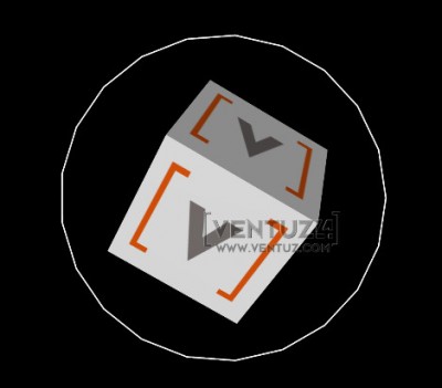

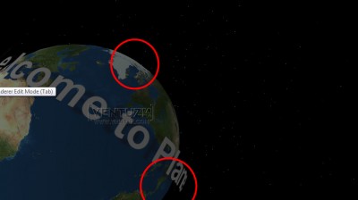

I am just getting started with Ventuz...what is the best way to use a sphere or a torus so that they look real? Right now I see a lot of polygons on a torus. Please see images attached. Thank you!

Hi there,
Every Geometry inside Ventuz has a tesselation property use the right mouse to uncollapse the tesselation category.
Re: Polygons on a Torus or Circle
Thank you Daniel, that worked. I kept left clicking on the "Tessellation" button and nothing happened until I realized that right-click does the trick. Thanks again!
