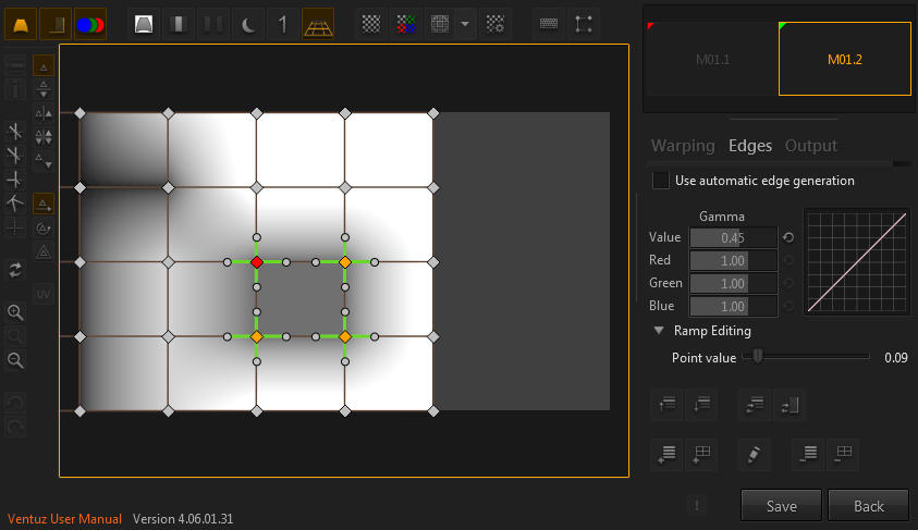

Still not getting this figured out. I am trying to use the Shaping editors Edges to boost the blacks of a Set of points in a layer. But it seem like the ramp editor is only changing where the White level max is, it doesn't seem to boost the black from 0.
In my mind the image below of the ramp editor would have the the blacks lowest value boosted by something like 10%. Am I think correctly and it isn't working or am I mistaken on how this the ramp editor works?

I have been able to boost the blacks on the output as a whole. But I need to be able to boost the blacks for specific regions due to it being some standard RP Screens and Projector mapped items on stage for a different projector end up over lapping slightly in the bottom corner of the screen.

There is no official way to boost black levels in certain regions, unfortunately. The edge blending can only make things darker (the color from the ramps is multiplied, not added). The color correction only works on the whole screen.

Did you see that when you disable 'Use automatic edge generation' you have full access to the edges?

Yes, very useful and functional when needing to do custom edge masking. But it only give you white level(or rgb) control of the peak level.
The extra level of control that would be nice to have added is if you could have black level or bottom end of the Curve Editor control how Low the black goes. As in the picture I posted before the blacks would really be about +5%(grey) and white would go to 100%. Most pro level projector with native edge blending have some type of control for this, but not with as good of tools for customization of points.
So if you are dealing with LCD projectors you can set the custom edges so that when ventuz is black that region is actually sending a grey(+5%). So that the black of the non projector overlap area matches that of overlapped blacks.
