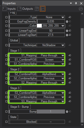

The properties in the property manager.. how are they sorted? (see image) I thought this would be alphabetical, but I get the feeling there is some randomizer at work. And it seems like the order is not static. When I started this container it was ok, but at some point the order changed. Also copies sometimes get a different order. This is hard to work with.

This might be connected to the second part: the fact that the whole property-expose-feature is buggy. I'm trying to come up with a reproduce for that, but so far it's all too random. Ventuz switches out the exposes for my values randomly. When I double click on an exposed value to edit it, Ventuz randomly selects Values and Categories from all exposed values... very weird. So far it was just a bit annoying, but today it really cost me time. I gave a complex container to my colleague and when he used it, nothing worked as expected. There were exposed values with the same name, but different categories. Like:
Mapping1 exposed as:
[Stage 1]
Mapping
Mapping2 exposed as:
[Stage 2]
Mapping
And after copying the container, the binding was changed to:
[Stage 1]
Mapping
[Stage 2]
Mapping
Thus making it impossible to work with the container :/
As I said before, it's very hard to come up with a reproduce. This only happens with complex containers with several exposes (and maybe after some copy&pasting). But I'm working on it and maybe someone else has already noticed a behavior like this.
