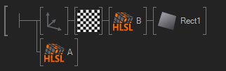

Take a look at the image:
Shader A sets the sampler settings hardcoded:
Code: Select all
sampler TexSampler : register(s[0]) = sampler_state
  AddressU = Border;
  AddressV = Border;
  Filter = Linear;
Shader B is in a parallel part of the tree. In the texture node (not in the shader itself!) the settings are:
  • Mag/Min: Point
  • U/V/W-Filter: Wrap
However the settings from Shader A override those done in the node in front of Shader B. Permanently! That means even after deleting the Shader Node A the effect remains. You'd have to save, close and reload in order for those overrides to disappear.

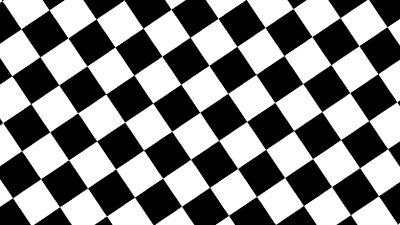

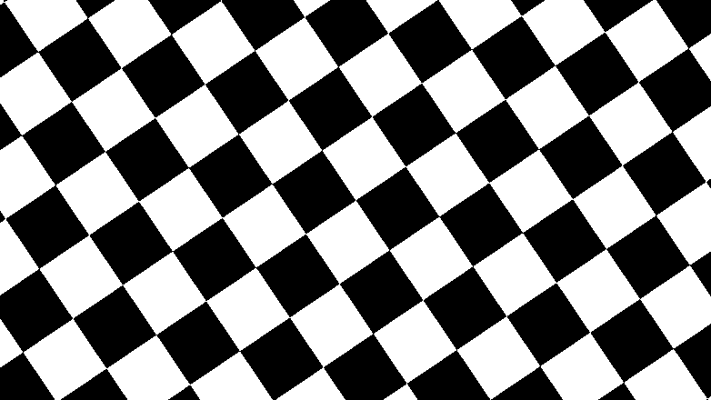

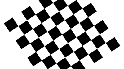

the tree with both shaders
this is how the render output looks after the values are overriden
this is how the render output should look like
