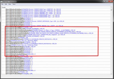

there seems to be an issue with how Vertex/Index Buffers are handled, when there are custom shader nodes in the scene.
In large scenes with lots of meshes( > 500 or so, I'm just guessing though, might be alot more),
everytime a node in the hierarchy is changed (added, moved, deleted) Ventuz freezes for a significant amount of time.
The more meshes the longer it freezes.
I have traced the DirectX calls and noticed that in all frames a node is modified, it reuploads what looks like every mesh in the scene.
This causes at least 4 times as many api calls and about 800mb of transferred data in our scene.
Going by the 800mb, maybe there are also textures involved, but I don't really want to dig through 200000 calls to find out.
Going by some simpler test scenes this seems to only happen when there are shader nodes in the scene, but I have not tested enough to be sure.

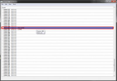

Re: D3D Performance
Yes this is about Designer.
Of course the scene will freeze on larger projects for a short amount of time, but we are talking about 2+ seconds here for every hierarchy change.
But deleting all shader nodes from the scene, the freezes go back to their normal level what you would expect from a large scene. (a couple of milliseconds)
A little illustration: That highlighted frame is when i drop a new axis node into the scene.
We suddenly have 50k extra api calls with 8.5e+02 MB (850 MB) of transferred data.
All of these extra calls consist of something similar to this Now I am not particular familiar with DirectX (I use OpenGL mostly), but that looks very much like uploading a mesh.
Obviously when this happens a couple of thousand times in a single frame Ventuz will freeze for a significant amount of time.
But I don't see a reason why this has to happen when I create, move or even delete a node from the hierarchy, every single time.
It's not like creating a color node would suddenly invalidate all mesh buffers at once, or even a single one.
As mentioned above this only happens when there are custom shader nodes in the scene. I have not tried it with the builtin ones though.
So there clearly seems to be an issue with buffers getting invalidated, when they shouldn't.

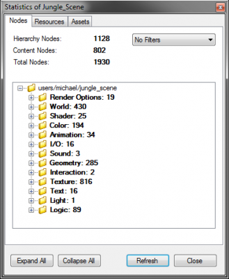

Well, I'm back.
Sadly I have not had any success to nail down the problem or effectively reproduce it in a simpler scene.
It is very inconsistent.

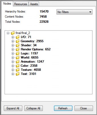

Here is a screenshot of the scene statistics if that is of any help Anyway, I am going to put this on halt for now since I'm out of ideas.

Re: D3D Performance
Hi Michael!
Your scene is pretty huge! 23k nodes with 15k of them being Hierarchy nodes is actually the problem why you have stalls if you change the hierarchy tree.
If you add or delete a hierarchy nodes, the complete tree is recalculated and re-validated - this takes time.
The only way to reduce these stalls would be to modularize your scene and use ScenePorts. Scenes inside ScenePorts are not re-validated if the parent scene tree changes.
If you want to take me a look inside your scene, please write me a PM.
