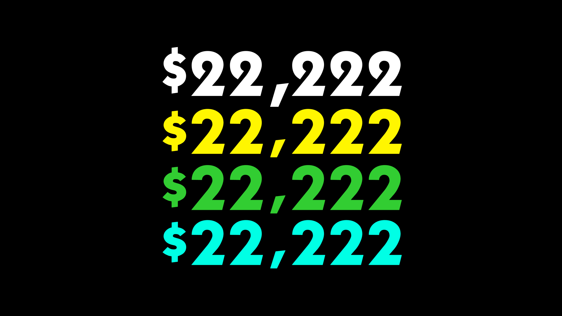

Here's another head-scratcher with fonts.
I modified a valid TTF font from scratch using Fontographer. I was able to successfully load that into Ventuz. I made a simple scene with a 2D text node and put up some block text. The Plain layer displays the original version of the font, NOT the modified version. But if I add text effects to that node, ALL of those effects use the modified version of the font!
I'll admit that I'm not very experienced with Fontographer, but the font displays correctly in all other Windows programs. So why would the plain layer use the original version of the font and where is it getting that from?

Christian Krix Schmidt
- Posts: 290
- Joined: 18 Jan 2012, 11:36
Re: Newly installed font not displaying properly
I think that has to do with the Font cache. The new layers are using the modded version because the fonts were created afterwards and the base layer is using the old ones. That should be the case if the file name is the same. (I think
) Try closing Ventuz, delete the Ventuz font cache, restart and load the scene again. Then it should only use the modded, new version.
Forgive my ignorance, but where is the font cache located?
- Posts: 290
You can find the Font cache in C:\ProgramData\Ventuz4\Fonts
robertwinter
- Posts: 49
- Joined: 27 Nov 2012, 21:53
That fixed it! Many thanks.
