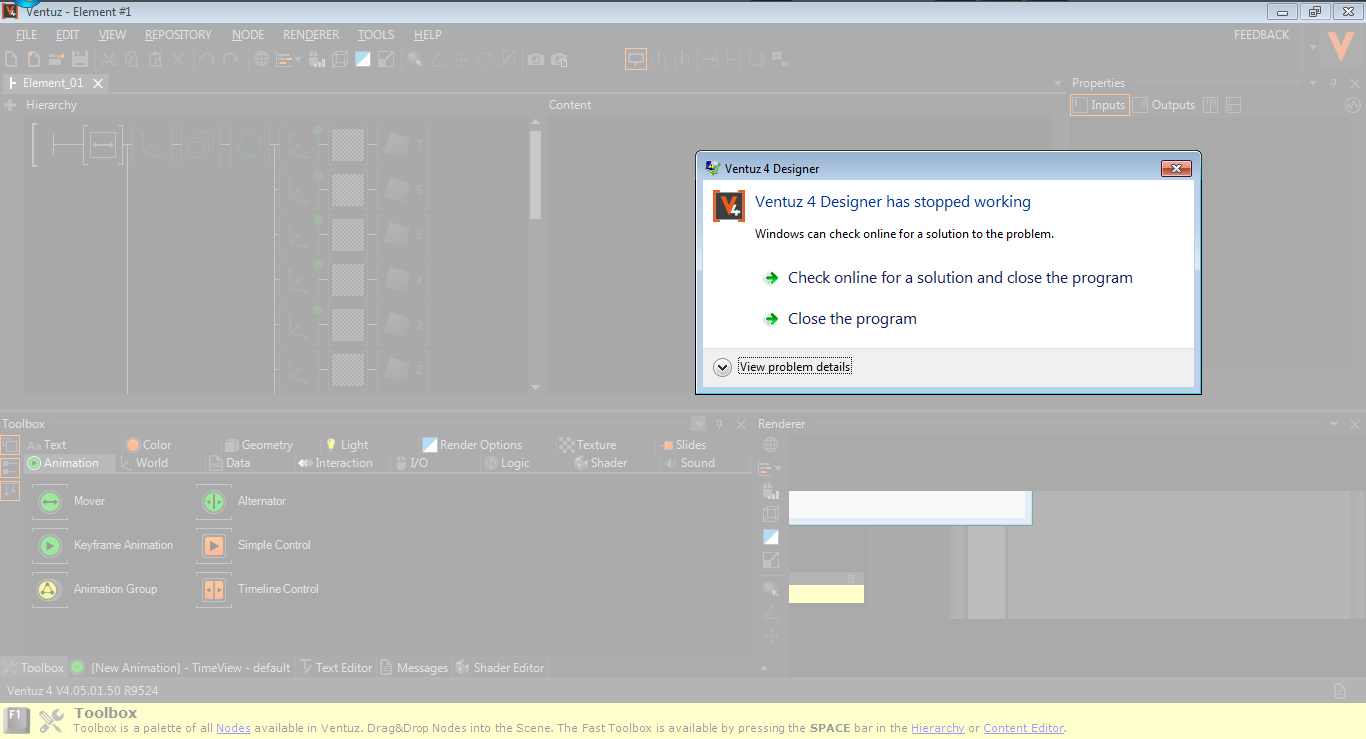

It's happing all the time when I am trying to open my scene from my old projects. It's also show me AppCrash window even after opening scene for new project.
I couldn't work with Ventuz because it's crashing all the time with this Problem :(
Can someone please help me fix it?
APPCRASH
Problem Event Name: APPCRASH
Application Name: Ventuz.exe
Application Version: 4.5.1.50
Application Timestamp: 543ce39d
Fault Module Name: ntdll.dll
Fault Module Version: 6.1.7601.18247
Fault Module Timestamp: 521eaf24
Exception Code: c00000fd
Exception Offset: 0000000000053443
OS Version: 6.1.7601.2.1.0.256.1
Locale ID: 1049
Additional Information 1: 4d2d
Additional Information 2: 4d2dfd4745a542480292eab4481b8422
Additional Information 3: fab4
Additional Information 4: fab4e63f8f85971086aa7a4a05dab180

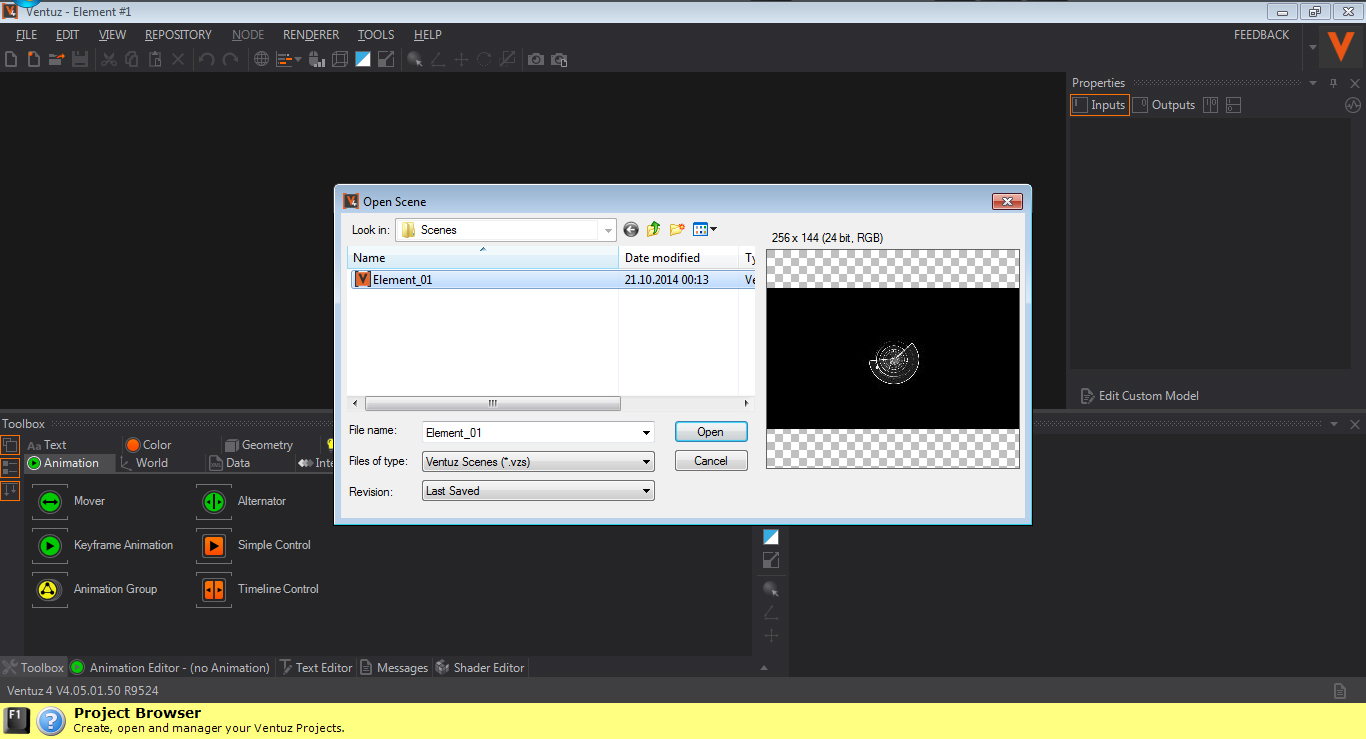

Hi Karol,
This is happen with all scenes.
Please check the attached scene that has worked before that problem.
Element_01.vzs
(30.42 KiB) Downloaded 484 times

Hi!
I can load the scene without problems!
Can you copy this scene to a new project without resources and try to load it?
If it loads successfully could you post a VZA of this scene with all resources?

The problem is that I couldn't open any project even create new. When scene of new project is opening it's trying to open "Renderer" viewport, after that it shows AppCrash window. I deleted Ventuz twice and install it again all this time, but it didn't help to me. I think the problem not in files. The problem in Windows and I don't know how to fix it.
