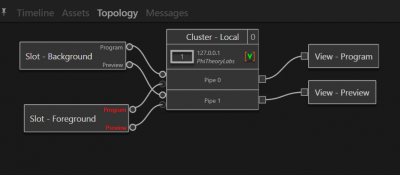

Trying to get the multi channel set up. I can't seem to get the the second channel to connect. Seems to me be something with the local machines ports because when I launch a show the 2nd port grays out(see images below). Guessing I have just missed a step along the way, maybe with the stage editor or layout scene?

Ok, I forgot to set up the layout scene in project properties... Up and running now.
