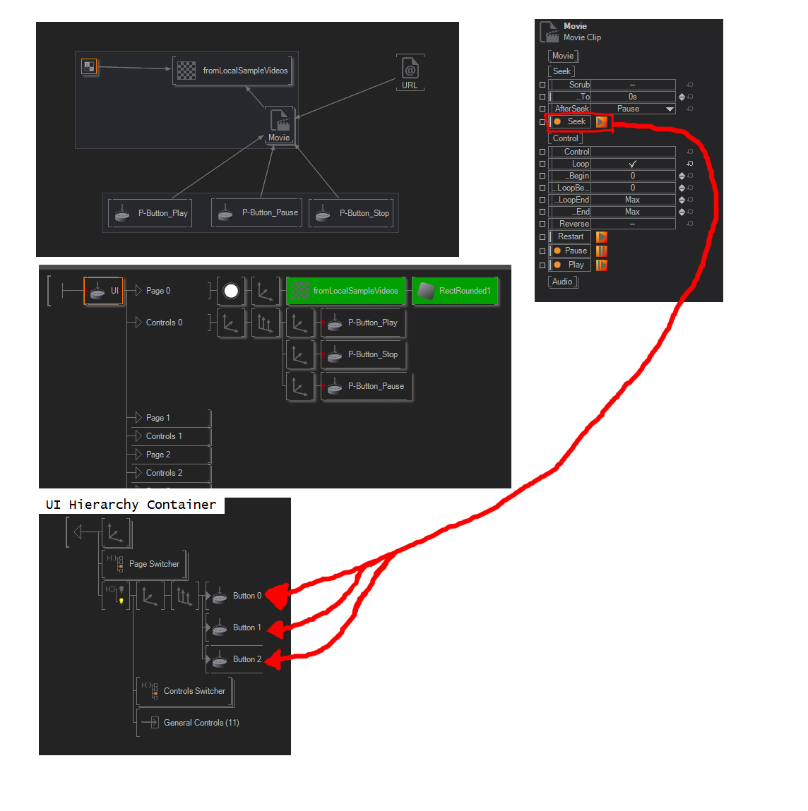

But I have another problem now, I'm unable to bind the seek function of the video to the UI buttons.
I'm not sure if I'm doing something wrong, I've attach an image of my scene contents hope it helps to understand my problem. Cheers,

Re: Stopping Video
Same thing here, expose the according output properties of the buttons.

Re: Stopping Video
and take care, that you use the events....not the bools!

tyle_cells
Re: Stopping Video
Woah, I didn't know I actually had to expose it a number of times.
