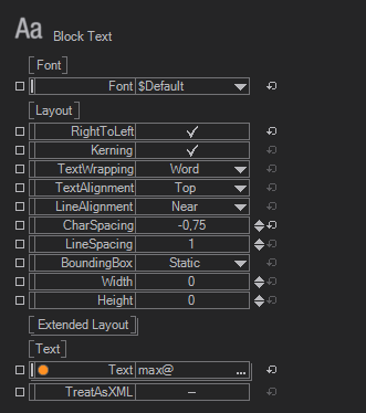

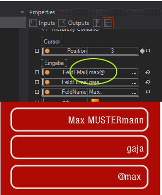

... and other funny things:
the TextNode:
Re: TextNode doesn't update with C#-Script
Posted: 26 Apr 2014, 23:07
by joschy

Btw, the switched "@" in the pics was gone after a restart of ventuz.
