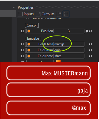

... and other funny things:
the TextNode:

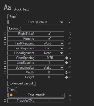

Post by joschy » 26 Apr 2014, 23:07

Hi Karol,
yes, i did. The C#-Script-Node seems not the problem, it works fine ;). I can see it in the property editor, it does what it should be to do. The problem i've got in to is, that the output bindings, which values are correct, are not updated correct in the TextNodes. The TextNodes are in different HierachyContainers, but i have the same if i connect a TextNode directly to the Output of the C#-Node.
The same with a different C#-Script which mange some int's, the output is a single int. The C#-Script forks fine, but when i plug the output to a int-expression, the expression don't work correct. My workaround, i use the output from the C#-Script ( the single int) as a event argument which reset a counter with argument-option on. That's work...
greetings,
joschy
Btw, the switched "@" in the pics was gone after a restart of ventuz.
