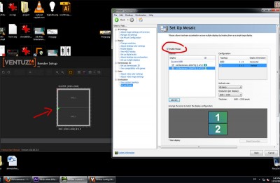

Hi i have a presentation (export->presentation) of 1920x2160 with two displays, one up n one down. In render setup i have done it as shown in picture but it didn't take effect unless or until i checked the "Enable Mosaic" in my graphics setup so is it necessory to enable it everytime? and if yes then what about low-budget graphics cards which don't have this option?

hi,
yes, if you want to make a presentation on more than one screen you need this setup! for low budget productions you can use amd gpus. the have an option called eyefinity...what is the same like mosaic with a different name
greetz
christian
