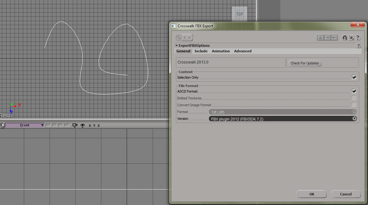

Forgot to add my fbx file. Splinemover reports it is not a valid file. Exported out of C4D v13

hi peter,
you have to create a bezier splines and export it in the ASCII Format.
See screenshot from softimage.
We test it with max, maya and softimage and it works well.
i don´t know cinema4d and i hope you get it running with the right export parameters.
