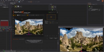

I found a bug when I tried to move points without warping.
Look outside of the warping zone.

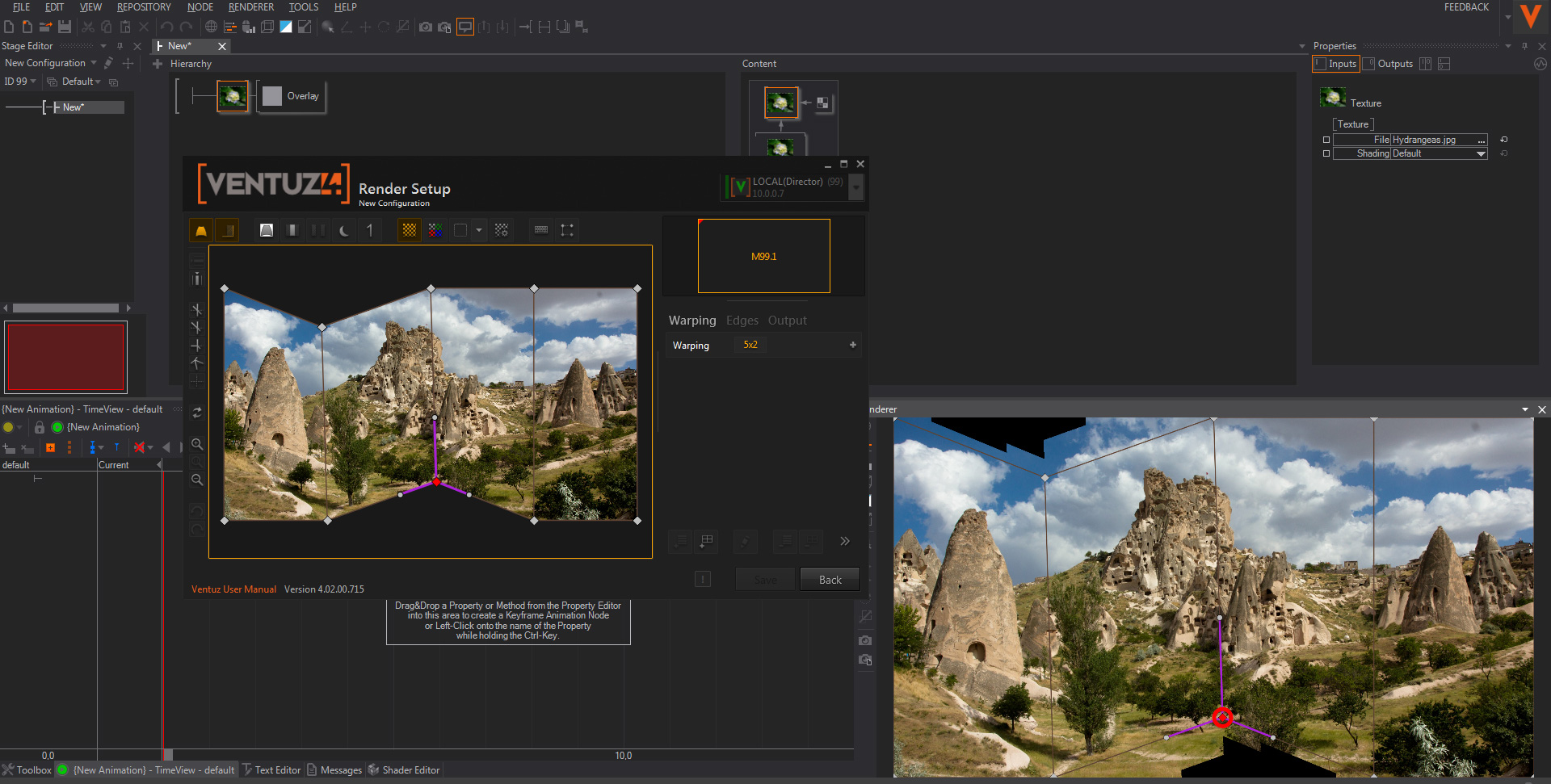

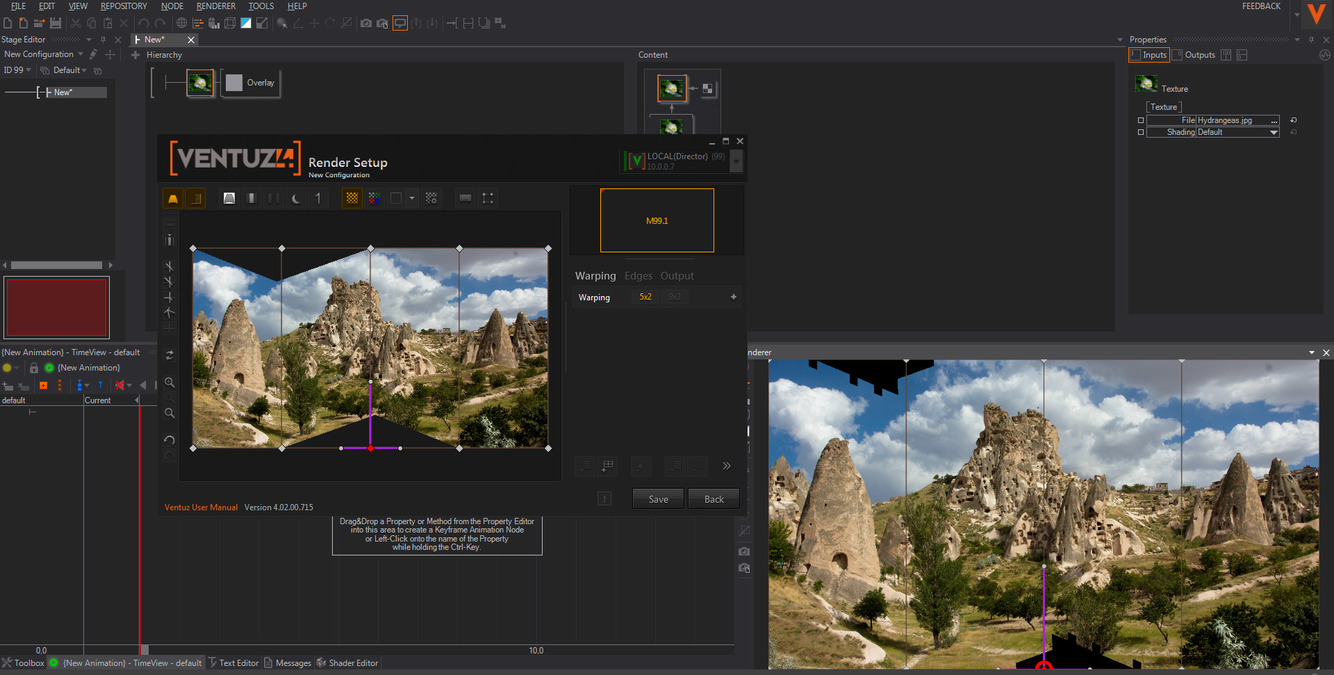

Is it normal that when I subdivide the warping layer the first layer lost the "moved point without warping"?

I was able to reproduce both problems and fix them. The fix will be included in Ventuz 4.02.01. Thanks for the feedback.
About the subdivide problem: Currently the original layer is reset when subdividing. This is not intended and will be fixed in the next release. The new, subdivided layer should carry on all information of the original layer even in Ventuz 4.02.00.
