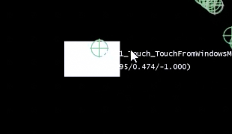

regarding shaping engine: i totaly agree....i already had the chance to test the alpha version on a 4 meter sphere with 3 projectors in overlap
regarding touch translation: i cant see any problem...if i test it on a single machine with mouse...everything is translated as expected. cant test it with tuio, but i think it will be the same.

Re: Overlap with Touch
Hi Chris,
Thanks for your reply and video.
Maybe I did not explain myself correctly. Looking at your video I see the same as I get. ie the mouse position and the position of the touch do not match up when using a blend or a gap between monitors.
This is a problem if on a video wall design of 3 x 3 monitors with large bezels - the touch would be out both vertically and horizontally.
Regards
Peter
Now I am puzzled!!
I created a 3 x 3 video wall set up with space between the monitors. I expected to find that my mouse position and touch 'circle' in Inputs Diagnostics would be out both horizontally and vertically. I am wrong, as it is working fine vertically. Works fine with either a space or overlap between screens.
I am now thinking this is a bug?
Peter
Hi Peter!
The behaviour you see is absolutely correct. Your content is doubled in certain areas due shaping overlap so is your Input Diagnostics rendering. Your Windows mouse does not know anything about Ventuz.
You cannot test this way! You are comparing apples and oranges
You have to test in Designer in the Design Preview modes or with the Presenter with correctly set up projectors - this will remove the doubled content.
