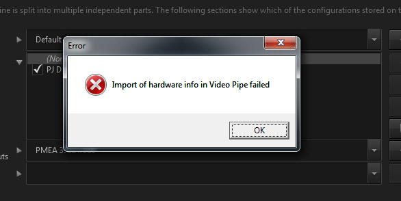

This DVI input card works fine under Ventuz 3. Unable to configure under V4. Just gives an error...
Have updated to latest drivers and Datapath viewer application is working fine.
Driver 7.4.0.502
Dated 21/8/2013
Windows 7

Same issue with the DATAPATH VisionHD4 capture card.
Am able to is disable and enable the cards inputs in device manager to coax it into working for a brief amount of time in V4 but its a process. Seems to work fine in V3

Problem reproduced and fixed (in the next release of ventuz)
