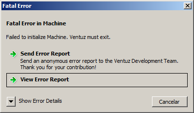

Hello.
I've tried to install Ventuz4 several times, and every time I have this message when I try to run it.
I don't know if this is a bug or is something relating my hardware, can you help me here?

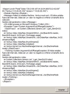

If this error still exists in the new version please remove all Audio/Video Input device in the AV Configuration and start Ventuz Designer again:

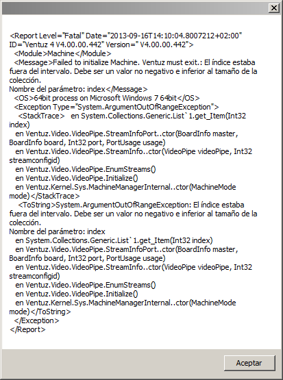

Regarding the Audio/Video input device in the AV Configuration, do you mean on Ventuz Config Editor? I didn't set up anything there, but when I try to make a new configuration on the Audio, Video and Hardware Mapping - I think that's what you're talking about -, I get this message: "Index was out of range. Must be non-negative and less than the size of the collection. Parameter name: index".

Which hardware device that are related to audio and video are used in your workstation?
Carlos
Re: Failed to initialize
Post by Carlos » 18 Sep 2013, 09:13
Hi!
I have a Blackmagic Decklink Studio, and an Epiphan DVI2PCIe. Could that be the issue?
