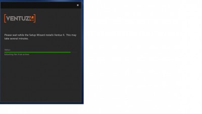

Re: license
I can't install Ventuz 4, Nothing happens after (maybe) 90% of install.
I'm waiting since One hour...
Re: license
Extracting the files is less than a minute.
Maybe your download is not ok.
I would try a new download.
Ventuz4 needs DotNet Framework 4.5. It would be better to install (and updating it) first.
Re: license
My download is OK, and Framework is ok..
Dońt Know..
Dońt Know..
Christian Krix Schmidt
- Posts: 290
- Joined: 18 Jan 2012, 11:36
Re: license
There are a few issues I sometimes have. Open the installer exe properties and check at the bottom maybe you have to "unblock" the file as it came from another computer. i would also launch as administrator (from the right mouse click context menu) and make sure the file is not on C:\root or the desktop. some antivirus applications or domain restrictions prohibit running exe files from those locations.
