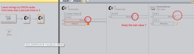

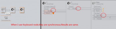

Post by allen hyoga » 25 Jul 2013, 11:34
I had a test on OSC and Keyboard node for the same C# passing structure.OSC made values different and Keyboard node works well.
Is there someone can explain why the OSC node caused an asynchronous value ? :?:

Post by chriss0212 » 25 Jul 2013, 12:10
dont know what you try to do but maybe this helps
greetz
christian
TestCmd2.vza
(7.67 KiB) Downloaded 478 times

Post by allen hyoga » 26 Jul 2013, 03:44
Hi Chris,thanks for your rapid reply.
It works if delay the event trigger. : )
However delay or timer control always depends on the performance(clock speed) of CPU.For a core or a xeon cpu, their result are different.I mean it is not steady.
I try a the same behaviour by the keyboard node.The time of passing value is synchronous with the event trigger.But OSCIn node is asynchronous,which cause my presentation show the delayed value when OscIn triggered. : (
Regards
AllenH
