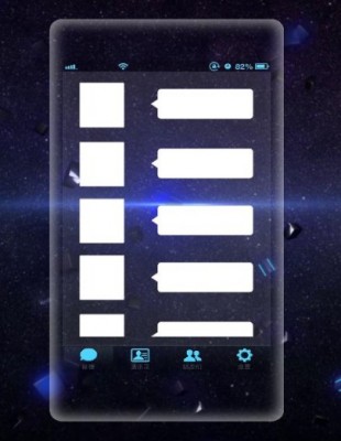

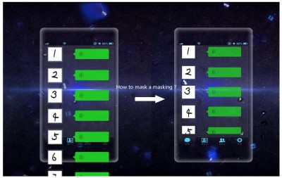

In my opinion,to do a mask effect in photoshop or flash is a very easy thing.However,I have no idea how to make a masking in ventuz,cause masking only works on texture.My application shows a short message list,so how to put the whole list behind the phone cover ?
An illustration is in below:

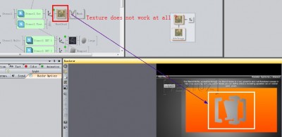

Thanks!! You remind me to use the Stencil Node in time.However,after I add Stencil Test node to my element tree,all of textures do not work,which are getting white!
Could you kindly help me to find the reason ? My project vza is attached.

You actually need two Nodes. Add the Stencil Set Node to define the area that you want masked. You do not need any shading of the geometry after the Test node. And add the Test node in front of your subtree you want to mask. Now choose the same Layer for both nodes and you are done. You can invert the mask using the property of the Test node. This way you can easily animate and control the masking independent of the content.

you used the stencil nodes reversed. You need to swap set and test. Additionally you need to respect the rendering order. There is a quick fix of your scene in the attachement.

Woooow!It works.Hi,you did a big favour.Thank you very much! :P
I think I need to make up the lesson of Stencil node as soon as possible.It's really a cute control.
