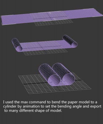

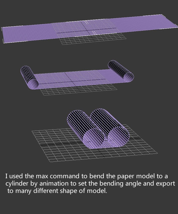

I just create a model with an animation(a complex body animation) and need to export this to many objs in order to get every frame model.So it can't export a whole obj(one file).Generally,we cant import a model with complex animation to ventuz(always used DAE),so I use this way that a model series to achieve the model animaiton in ventuz.

Yes,you are right,Chris.I used the baking method in my project always.However,we can not bake a complex animation to the obj, for example a paper roll to a cylinder,the shape of model is changed which is not a easy position animation(as you know this is a shortness of ventuz).So I gotta export every animation frame in order to get every different model(flat paper model,a curled paper model, a half cylinder model and so on, a model series as every frame of the animation).With those models,I compose them together as a whole model through importing one by one into 3dmax and group to export to one obj.Finally I can control the subset to drive the 'animaiton' in Ventuz.
