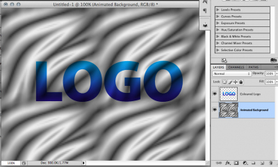

I'm still desperately seeking help with this
By tweaking the basic HLSL node, I've solved one element of this project (a simple blue rectangle which needs to multiply the grayscale underlying layer)...

But I still need a shader that will not generate the blue colour itself (as the above code does), but instead it needs to use the colours of the existing texture which is next in the node tree (logo with alpha) to multiply the underlying layer... Can someone please help me get this working?!
