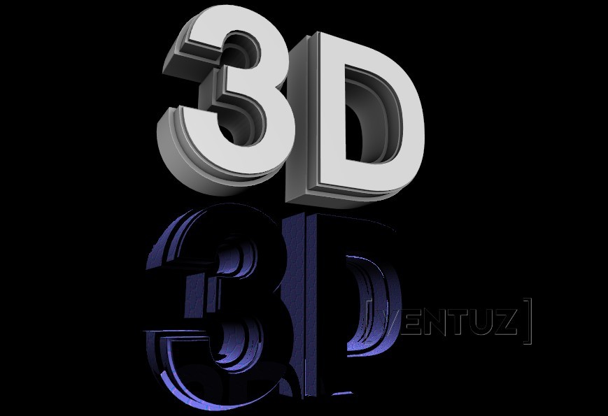

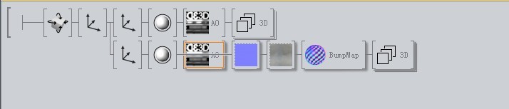

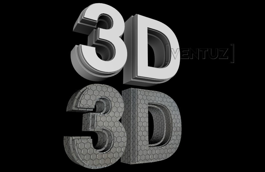

And I have another question that about the effect of multi texture.I give both a AO and normal texture for a 3d object.For one texture AO or normal texture,it shows well.However,I wanna get a better effect,including bump and real shadow.So I overlay a AO texture and a normal texture for this 3D Text model,it shows bad, which does not work just like in a 3D software(3dmax or maya) finally.
What's the reason, any way to carry out this kind of using multi texture ? I set a sample in the attachment.

havent tried specificly to bumpmap and AO a Geometry, but i can see the use case.
you got to set the blending stages right. That should do.

The Bumpmap shader can only handle 2 textures: a displacement texture and an optional diffuse texture.
The order of the textures is important: first is always treated as displacement map!
Cheers!
