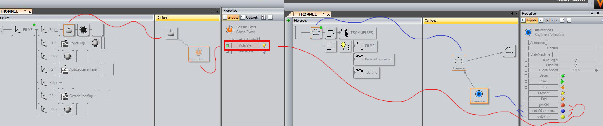

I need a tip please.
I have a touch button in a hierarchy which is linked with a SceneEventNode. (the red line)
How do I bring the singleTapEvent of the SceneEventNode to my "animationNode" (blue line) which influence my camera and which is not in the hierarchy?
I tried it with "exposure" but I have too less experience weather this is the right way and how to go further with the exposure concept.

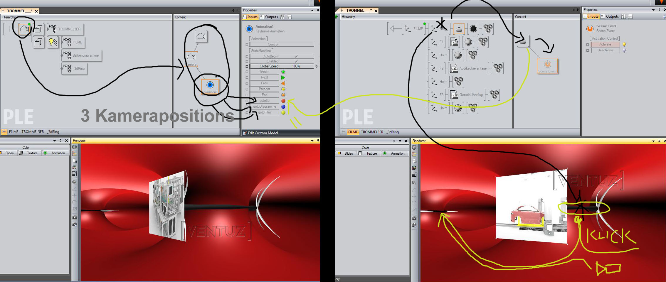

I try to describe what I want to do:
I have 3 axes : 3d/film/diagrams. I made a camera animation with three places to look at each axis.
If I click on the rings, which are rotating around each axis - the camera should move nearer to that clicked ring.
What do I have to link?

I think I got the mistake but I cannot solve it.
If I put a test touch button directly to the place where my animation-node is - the touch works and the camera moves.
But I have the touchbutton and it´s geometry in a hierarchy container and so it doesn´t work.
What can I do?

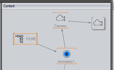

Chris - thanks for the example. But sorry I think I do not yet understand some basic things:
1. What I do not understand is why a singleTap is an output - isn´t a singleTap something what the user (mouseclick) does and that is why I understand a singleTap as an input?!
2. Exposure: I thought and red in the manual - the visible sign in the VentuzGUI that a method is exposured is the little green square near the exposured method. Are there other exposure actions then the RMB-exposure on a method? I can´t see that little green square in your example.
3.How did you transfer the hierarchyNode "FILME" into the content window (attachment)?
regards Marko
regards Marko
