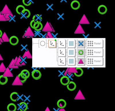

I try to build a sprite cloud with different sprites in Ventuz.
At the moment I build 3 Clouds with different Sprite textures, group them and get problems with the depth sort (z buffer).
Is there a way to build a cloud with different sprites and no alpha/depth problem ?

A Z-Sort node will not help to get rid of the problem because it is just sorting the sprite clouds against each other but not the sprites of one cloud.
You need to disable the Z-Test with a disabled Z-Testing node.

It looks crazy and creates confusion but it works fine with the alphasDaniel Willer wrote:A Z-Sort node will not help to get rid of the problem because it is just sorting the sprite clouds against each other but not the sprites of one cloud.
Cherio!
Thanks for the help.
