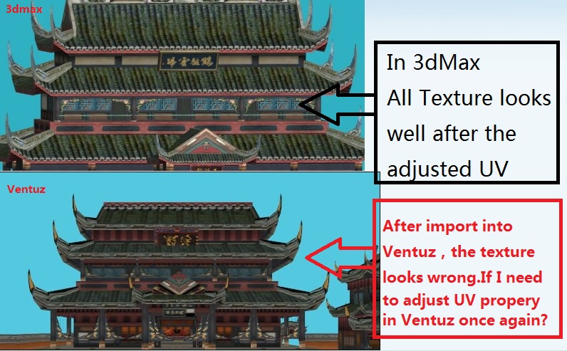

Another problem is about the texture in Ventuz.I upload a snapshot showed in 3dmax and Ventuz.You can see the texture ooks different between max an ventuz.I only adjust UV property in max and export a DAE format to ventuz.If i always need to adjust UV property in ventuz once again ? i dont think so ...

Ventuz imports UV coordinates. Do you have the same result when using OBJ? Or only with DAE? Do you use UV shells? Do not stack UVs. Do not combine multiple UV sets across meshes, etc. If you run into troubles like these, start of with a straight-forward and simple approach. Take a cube, texture it and import it. If that works, go to something more complex. The problem is either in the Ventuz importer or in your scene. I am having a few issues with the DAE importer and UV coordinates lately. So I switched to OBJ. If you have the same problem with both OBJ and DAE then your UV coordinates in MAX are wrong.
Re: Ventuz can load a entire project from 3dmax or not?
You are right, obj is same as DAE.I readjusted the UVs in max and it shows well.Christian Krix Schmidt wrote:Ventuz imports UV coordinates. Do you have the same result when using OBJ? Or only with DAE? Do you use UV shells? Do not stack UVs. Do not combine multiple UV sets across meshes, etc. If you run into troubles like these, start of with a straight-forward and simple approach. Take a cube, texture it and import it. If that works, go to something more complex. The problem is either in the Ventuz importer or in your scene. I am having a few issues with the DAE importer and UV coordinates lately. So I switched to OBJ. If you have the same problem with both OBJ and DAE then your UV coordinates in MAX are wrong.
Thank you, chris, it seems that DAE is a steady format in most time : )
And about the texture, only the hand-painted map can be used from max to ventuz directly...what a pity there are so many good texture(material ball, texture baking...) effect in 3dmax : (
