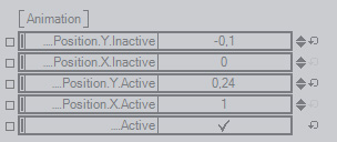

hi,
i have this issue with a hierarchy interface container, where the exposed properties are sorted in a strange way.
It seems to be sorted alphabetically, but inverted
I think it would be more conveniant if it would be sorted just alphabetically like its done in ventuz standard nodes.
If they got sorted like that, there's no way to change it, i tried to unexpose a property, cleaned up the interface and then exposed it again, same results :S
Does anyone else have had this issue yet and/or a solution?
greets
schub

its not even sorting inversed alphabetically, ideally it should look like this:
[Animation]
  • Active
  • Position.X.Active
  • Position.X.Inactive
  • Position.Y.Active
  • Position.Y.Inactive

Unfortunately the Properties are just an unsorted list it is on the roadmap to change that for future versions.
