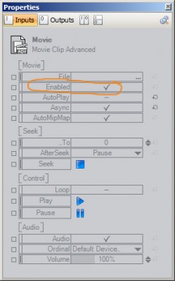

Hi wanzi!
If you have several movies then you should use the "Enabled" property of the MovieFrame or MovieAdvanced. Load your movies on demand like Karol suggested. Activate "Async" property so enabling and disabling the movie does not interfere with the Rendering. Animate or use logic to load/enable movies that you need and onload/deactivate those which you do not need.
This way you can have unlimited number of different movies in your scene. I highly recommend you do NOT use the Quicktime nodes.
Chris
Chris
