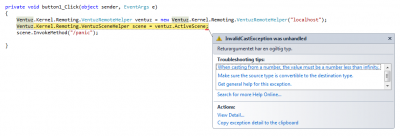

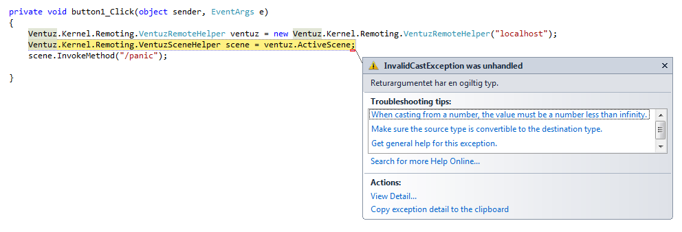

I have a simple application that sends strings and methods to ActiveScene.
I upgraded to 3.07.00 and therefore added new references to the remoting dll's in my VS-project
BUT... when I test my application now, I get an exeption from the debugger.
Attatched is the errormessage from VS and the corresponding logwindow from Ventuz.
Any ideas?
// Sam
VZ MsgWindow
VS Errormsg

Forget my last post...
It seems I (for some reason?) have Ventuz X64 installed both in Program Files and in Program Files (X86) on this machine, and the one that was updated was of course the one in (X86)
Sorry, my bad, everything works when I reference the right dll's
