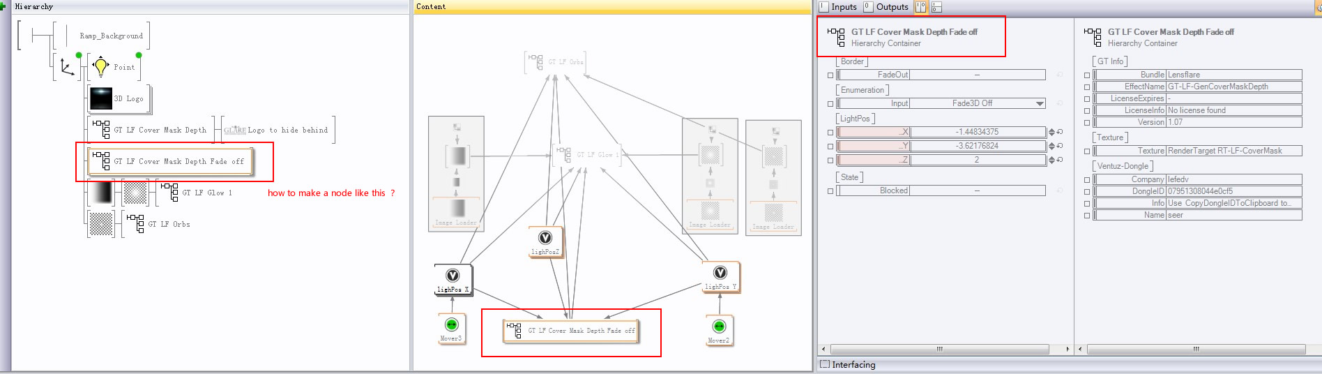

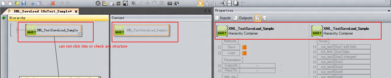

Recently i found many good ventuz plugin, but i have no idea what it is.Those plugins inherit from content container or hierarchy node,some inside properties are exposed, but i can not click into the next level to check its structure...anyhow i do wanna encapsulate some custom node with my script or logic embeded.I don't find any guide in official user manual.

in basic this is a normal hierachy container. if you create one und put some stuff inside.....and of course externalize all the properties you need....you can seal the container (right click on the container). this makes sure, that nobody can make any change....and nobody can take a look inside! espacialy for the plugins this makes sense! of course the creator want to get some money for theire work....and this prevents them that somebody else can steel his idears and work!
but take care, that you ALLWAYS make a copy of the container BEFORE you seal it! you can never ever open it again!

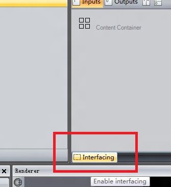

and what about “interfacing” button ? what function ?can i find detail in user manual ?

this is one of the best features we get in ventuz 3!
if you mak a container (doesnt matter if it is a content or hierachy container and copy it....maybe 10 times...after all you make a change in one container...if you mark all containers as interfaced containers you can copy all new featrures from one container to the next just by drag and drop the new container over the old one (hold ctrl AND left mouse button)
another very helpful feature:
if the container is allready interfaced...and you delete a allready exposed and binded propertie (for eg a float variable) inside of the container....the exposed property OUSIDE of the container will still be bounded to the next node! if you know create a new node inside which has a float as propertie...and now you try to expose the new propertie... ventuz will ask if you maybe want to use the old bounded propertie!! very very helpful!
hopr this is clear again
christian
