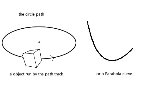

I have no idea how to create a spline path animation ?
In 3dmax or c4d, we can draw a path and set the camera or object to run by the path.So How can we do in Ventuz ? desc as below
and my worst thought is to hard code a script(use like SinX, CosX or other math function to calculate the path coordinate, then output them to the position of object and in real time ...however it is so ... )
any advice,thx

Re: How to make a path animation
thank u stefan,however
the diagram in user manual only introduces the interpolation type of animation but not the path animation which is an object track animation.
- Posts: 169
- Joined: 16 Mar 2012, 19:01
in Ventuz there isn't a path animation feature. You can't design path or 2D curves like we do in 3d modeling-animation softwares.allen hyoga wrote:thank u stefan,however
You assign key frames moving cameras and objects and their positions will be interpolated with rules: linear, bezier, etc.
You can't see any path curves in the 3d space. BTW you can import complex and articulated Collada animations.
Pay attention to the up Y vector...
