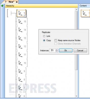

It would be nice to replicate nodes keeping an ordered indexation.
When I replicate several instances of a node the indexation is inverted.

Hi robert,
this is an know issue. This happens if you link the copies to the original node. To work around this problem you have to link to a dummy node that you can delete afterwards.
Cheers
Cheers
