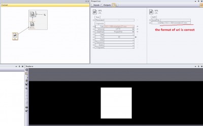

Before i set a absolute video path(D:\1.mp4) to the MovieClip node as the texture of a rectangle,it works.
Now i set a webserver video , just like http://192.168.0.12/video/1.mp4 which exsits on a mac apache, i can download it.however when i set the path to the MovieClip node as same as before, it does not work, MovieClip node can not transform this path to texture for use. Do i need a mid-node to convert the path,any help ?
How to set a webServer video to Movieclip node ?

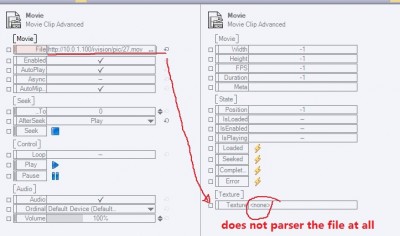

And the error msg is "14:17 2012/3/28 Error : Movie (Movie Clip Advanced): Error creating Movie Resource: http://10.0.1.100/ivision/pic/27.mov: HttpFtpSchemeManager.GetLocalFSPathCore"

Re: How to set a webServer video to Movieclip node ?
Hi!
The Movie Clip Adv. node is currently not able to display streamed video content.
Thanks Karol, i found that old MovieClip node can only support wmv stream video and my OS is win7 64bit, on which QuickTime node does not work at all.So I use MovieClip Advance Node to Play QuickTime Video(.mov/.mp4) with absolute path, which works well.However, when I change the path to a webserver url, it does not work.Your given blog is written in 2009, i wanna know if there is some update to support the QuickTime stream video, after all old MovieClip + MovieClip Advance can do in theoryKarol wrote:Hi!
