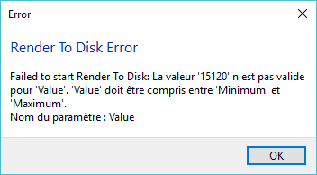

Since v5.2 I have this error message when I try to open the render to disk.
I don't understand why it is an error now because it wasn't a problem before?

huge resolution render to disk
- rtd error.png (4.51 KiB) Viewed 4055 times

Render2Disk works for me. I just tried 16000 x 16000 pixels with PNG output on the latest V5.03.01
What output format are you using? Could that be the problem?

Hi Robert!
There is a bug in 5.3.1: Render2Disk does not start in designer if the project resolution is beyond 4096 pixel.
Best Regards
Best Regards
