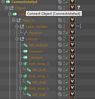

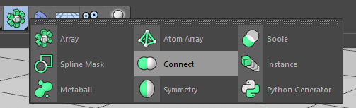

Re: Cinema 4D "Cloner" to Ventuz ?
Connect is a "modifier" inside C4D
here is how i use it ... and where to find:
best regArts
